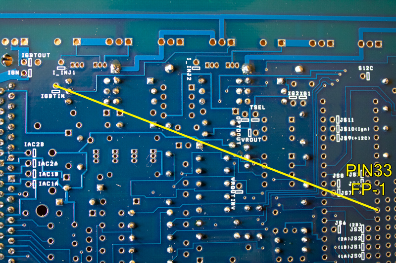

Hello James, thanks for your help.
so if i understand you right, you advise to use one of the INJ outputs of the lower Connector for the FAN-Control.
For example PIN32&33(INJ1) or PIN34&35 (INJ2)
Max current is also 5 Amp ?
And concerning the fuel pump output.
As long as there is no solution via the firmware, can i jump wire the CPU PIN 33 (FP-1) to IGBT-IN?
Then connect my fuel pump to PIN36 of the lower DB37 connector? (Do not connect the regular FP circuit)
So i could leave the setting in TunerStudio on "ON/OFF" and use the ignition transistor to control my fuel pump (without a relais)?
BIP373 installed like descriped in STEP 28 of the assembly manual on msextra.
BTW: In the Built-Manual on http://www.msextra.com/doc/ms3/build_manual.html is there a mistake? Because JS10 is not mentioned and not connected to anywhere? Would it even be possible to use the single high current igntion output IGN (PIN36) if i assemble my board according to the manual?

Max is 18A (per INJ1 or INJ2) - so long as you have enough ground connections.CKP hat geschrieben:Hello James, thanks for your help.
Yes, that could work - but you need to install a 330R resistor between the processor and IGBTin.And concerning the fuel pump output.
With MS2/Extra and MS3, JS10 is more often used as the cam input signal. That is why the manual does not show it connected as an ignition output. However, it is possible to used it for a single ignition output.BTW: In the Built-Manual on http://www.msextra.com/doc/ms3/build_manual.html is there a mistake? Because JS10 is not mentioned and not connected to anywhere?
